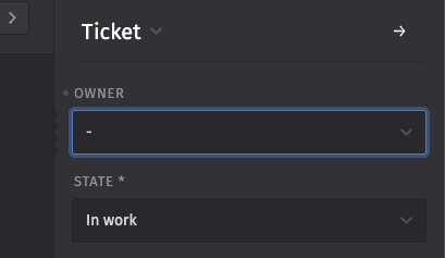

Yes, agent set itself as owner, however when he left ticket and open it again - owner field is blank
Agent open ticket, set himself owner again and story repeats…

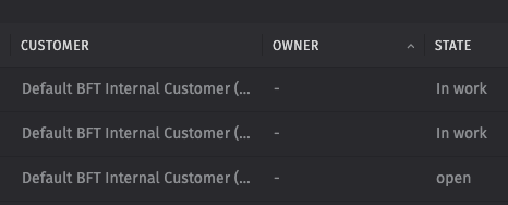

i attached screenshots
as far you can see, all of them have no owner
This might be a silly question, but did they update the ticket after setting themselves as owner?
yes, they are, i also get same issue with my own tickerts
You could check the ticket history for more details about the update.
Normally this “-” happens only when for example the agent is no longer available as an owner for a group or some other special situations.
