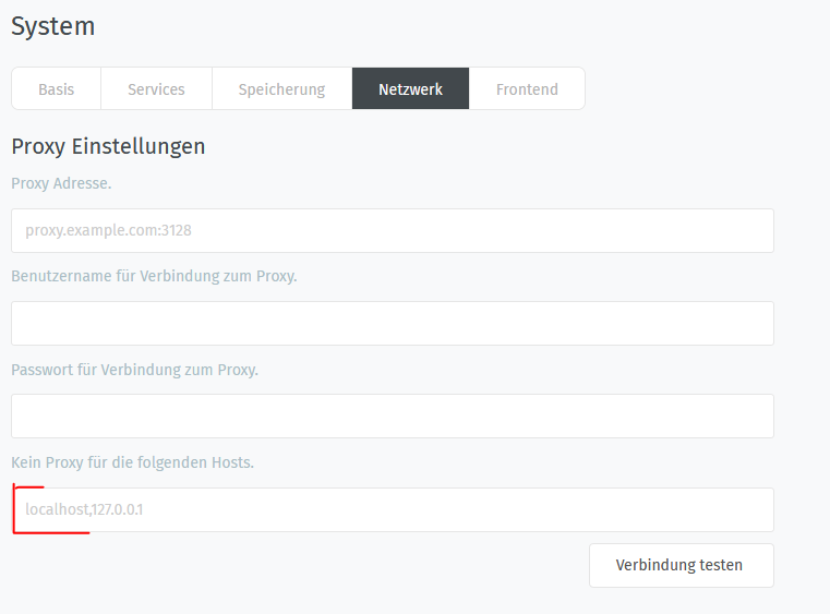

LoL.
i deleted the proxy, but it was not saved cause the last input was not manually deleted by me:
its working
Sorry…
Glad you found the solution, never would have suspected left overs from proxy settings.
