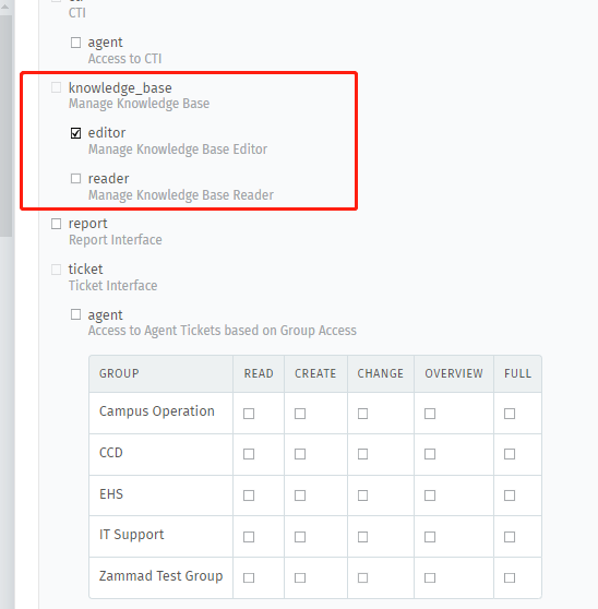

I’m not sure if I got your point but we do have roles, one is agent - IT, one is agent - Finance, however, I created a new folder in KB named IT then edit its permission, I didn’t see these roles in the permission table. that’s why I’m feeling lost… there are only System admin and normal Agent field.
I then created a few new roles for KB permission purpose only, I can see the new roles in the table, but I can’t figure out how to set the role permissions. There are only edit and read permissions for KB field. If all the new roles are editing permission, I didn’t see how some of them can read and some of them can edit our IT folder? I’m not really sure how to set the proper permission for the roles, if you could further advise?
