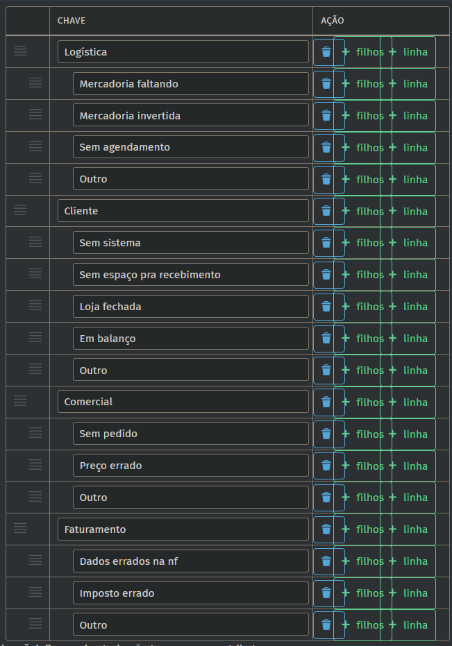

Here is my object (single tree select) structure:
Question: What value do I use in api to correctly fill the ‘origemprolema’ field and successfully create the ticket?

Should normally very easy:
   "title": "Help me!",
   "group_id": 4,
   "customer": "customer1@example.com",
   "description": "testing ...",
   "treeselect": "Cat 2::aaa"
fieldname: "value" and sub tree values are connected with ::.

You are absolutely right!
Using the zammad integration on N8N is throwing the error…
Doing as you told via a simple post worked!
