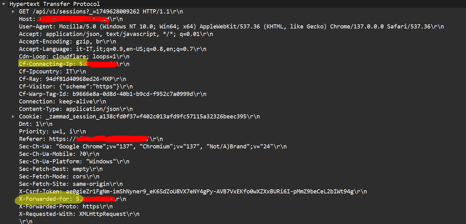

Currently i’m getting the IP address of cloudflared container and not the real IP of the customer that access the ticketing system
It’s strange because on each http request from cloudflared, I’ve both Cf-Connecting-Ip and X-Forward-For with the right IP, but on the Zammad console (and emails) still get private one:

There is something missing on the configuration probably that prevents to read headers correctly.
I had a similar issue with an Apache Reverse Proxy. I had to add the following lines to the Zammad httpd conf on the Zammad server (Apache).
RemoteIPHeader X-Forwarded-For
RemoteIPTrustedProxy <proxy-internal-IP>
