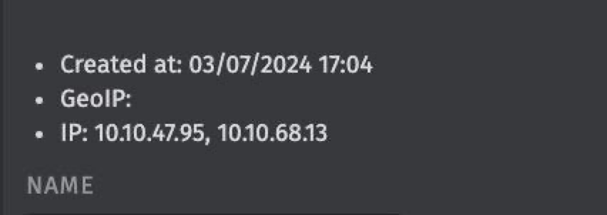

GeoIP helm not works
  • Used Zammad version: 6.3.1
  • Used Zammad installation type: helm
  • Operating system: EKS 1.29.3-20240605
  • Browser + version: Safari latest
I tried to set trustedProxies in Helm, but still did not work.

How to get GeoIP working ?
Would you mind sharing where you have this UI part from? A little bit more of information would be fantastic.
it’s from chat details
and also when I open sessions
10.10.x.x is a private network address. Of course you will not receive a valid location.
yes, of course, 10.10.0.0/16 is a local VPC, but how can Zammad get an external address?
Does the user have an external ip address or is the user on the same subnet or network class like Zammad?
let me add zammad.yaml so you can understand the situation better
  • There is access via the public Internet, in that respect everything is ok

maybe it will be useful to someone
fixed by adding to ingress-nginx
  config:
    enable-real-ip: true
    use-proxy-protocol: true
full file
controller:
  service:
    annotations:
      service.beta.kubernetes.io/aws-load-balancer-cross-zone-load-balancing-enabled: "true"
      service.beta.kubernetes.io/aws-load-balancer-type: nlb
  config:
also in in LB “Traffic configuration Proxy protocol v2=On”, “Preserve client IP addresses=On”
