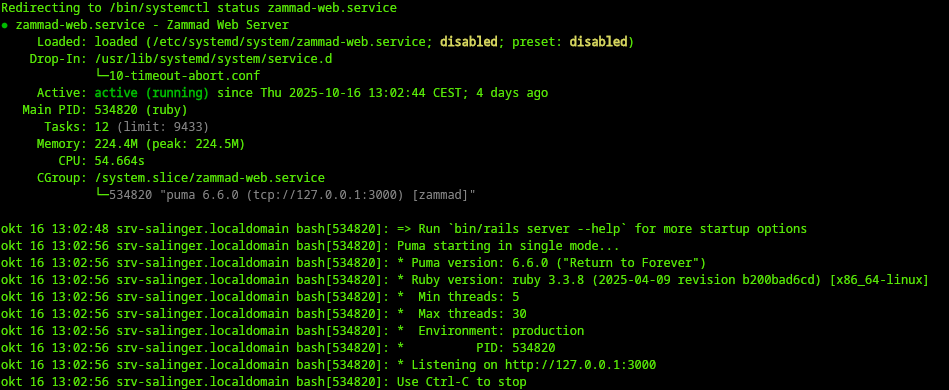

How can I check the availability the Zammad services without proxy ?
The traceback is incomplete so hard to tell what exactly is wrong.
You should see the Ports 3000 and 6042 in use. I’d say this is not the case, I’d even bet that the services are not running correctly.
You may want to use a package or docker based installation. The source code installation is by far the hardest installation method.
Checked the ports with netstat:
[root@srv-salinger ~]# netstat -na | grep “3000”
tcp 0 0 127.0.0.1:3000 0.0.0.0:* LISTEN
[root@srv-salinger ~]# netstat -na | grep “6042”
tcp 0 0 127.0.0.1:6042 0.0.0.0:* LISTEN

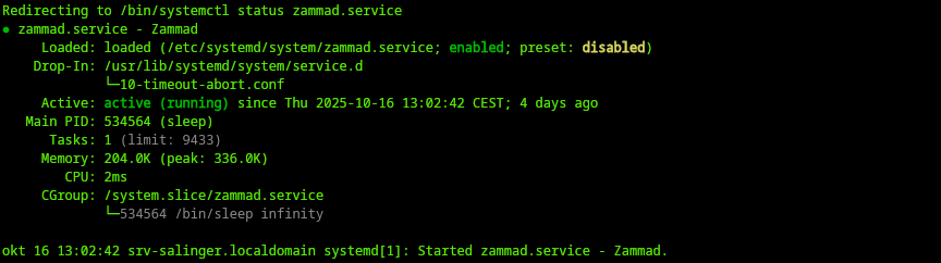

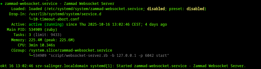

And all of Zammad services are running:

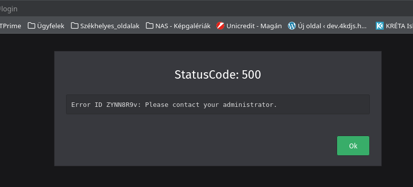

Now I have error message from Zammad. The production log give this error:
app/controllers/application_controller/handles_transitions.rb:16:in handle_transaction' E, [2025-11-04T11:58:55.984034#211416-196520] ERROR -- : Error ID 67RY1rTC: undefined method ’ for nil
I, [2025-11-04T11:58:55.984617#211416-196520] INFO – : Completed 500 Internal Server Error in 85ms (Views: 0.3ms | ActiveRecord: 4.7ms (117 queries, 111 cached) | GC: 0.7ms)
But Zammad generally works…? If so, a new Thread might be a good idea. Even uf bot, provide the whole traceback. This is not enough to understand what‘s happening at all.
Hello. Attached the screenshot from Zammad and production.log.
