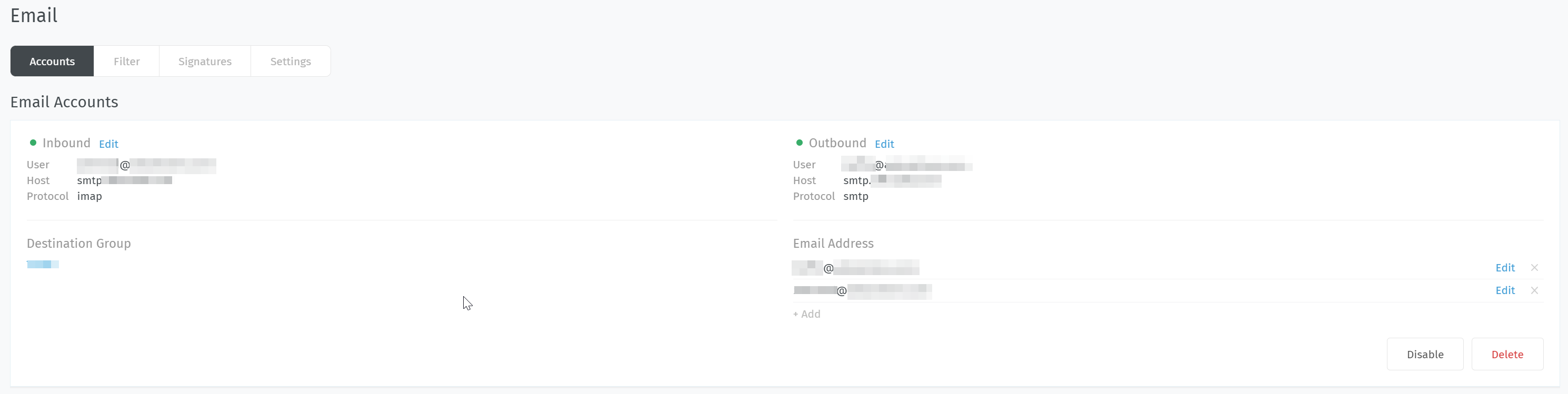

for me it seems to come land at the if…not the else, since i receive them with the configured smtp address;
i’m using the docker-compose as well and i didn’t need to change anything related for the emailing.
