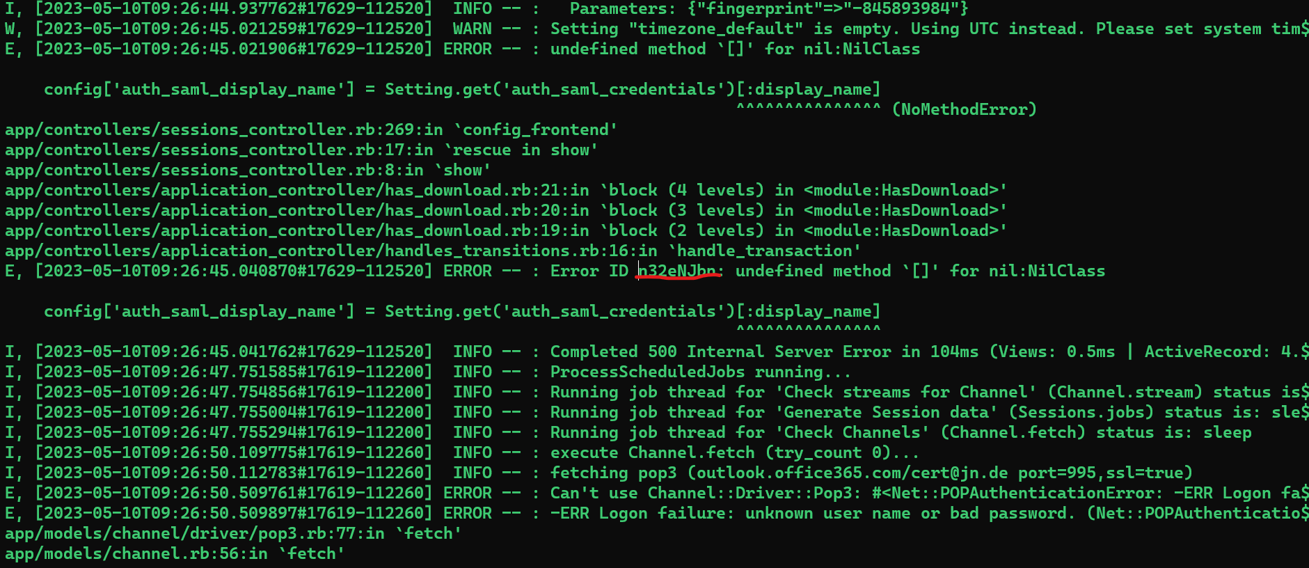

We still have the same issue Error ID n32eNJbn
There’s always a new Error ID when refreshing the login page. The previous ID is the last one.
Thank you
You need to search for the Error-ID in the production.log and hopefully there should be some information present about the error.
Thank you, but I don’t understand what’s wrong there…
Looks like the migration was not executed or not executed correctly.
So you could try to run the migration again.
You could also check the output of the following setting (execution could be different related to the installation):
zammad run rails r "pp Setting.get('auth_saml_credentials')"
It seems to be correct because this error has occured after updating to the latest version.
I’ve executed the command and the result is nil
Yes, this is the main problem then.
The auth_saml_credentials setting was added around 4 years ago, seems to be that the setting was removed manually or the migration in the past didn’t work (when the system is already that old, otherwise the initial installation was not correct).
