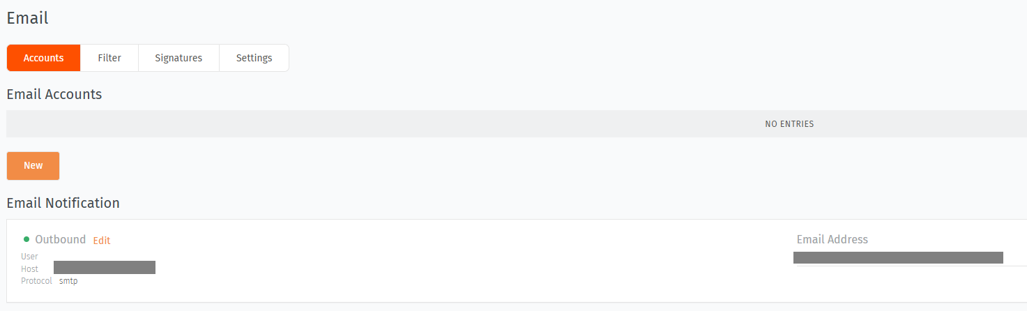

When looking at the email notification channel, it was missing when viewing it from the console, and it appears that it was deleted. We pulled a backup of the database and altered the Channels table to insert the configuration back. It now shows in the gui and console. It’s enabled and we can edit it.

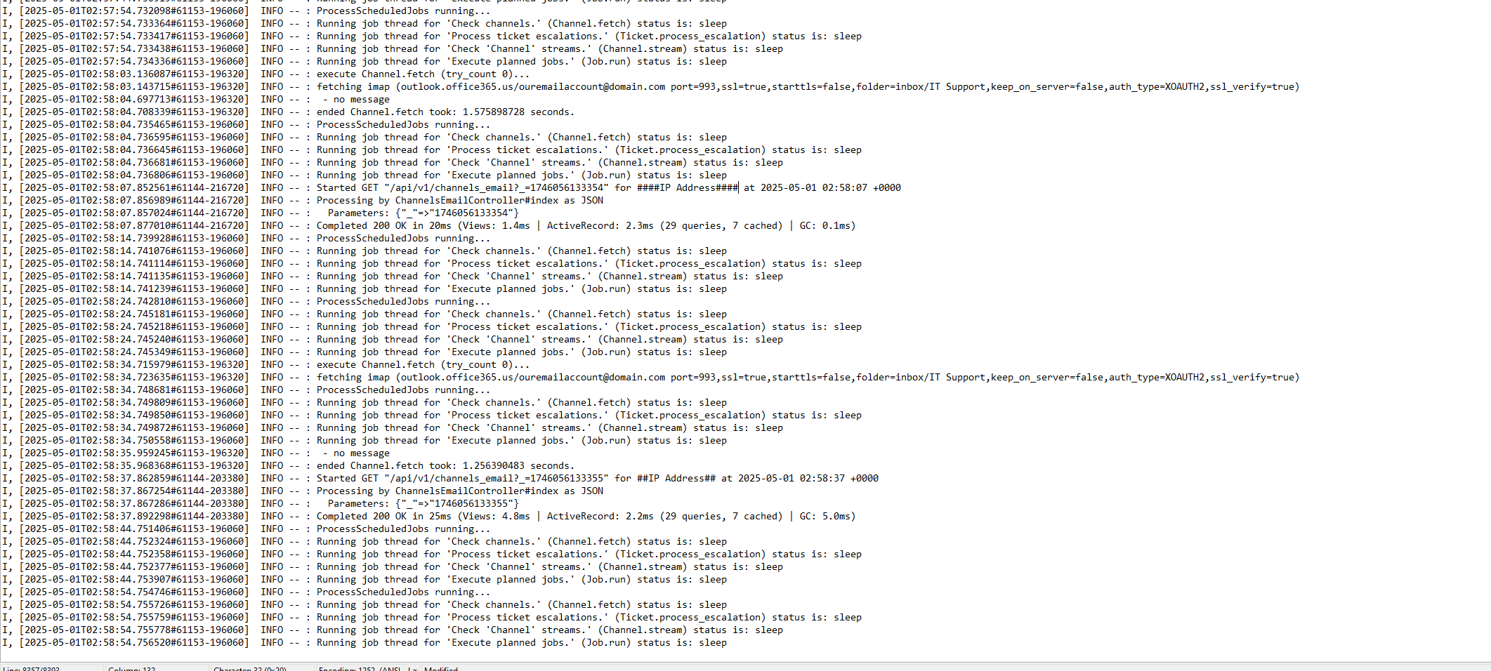

When viewing the production log, we can see when a new ticket is submitted, or email picked up but don’t see where any emails are being sent. Also don’t see any SMTP errors.

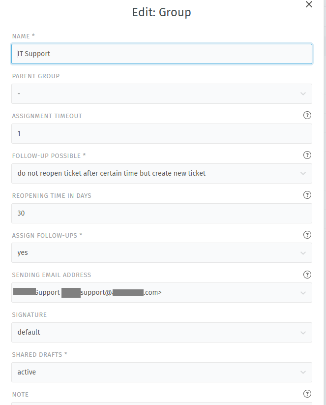

Groups have email addresses assigned.

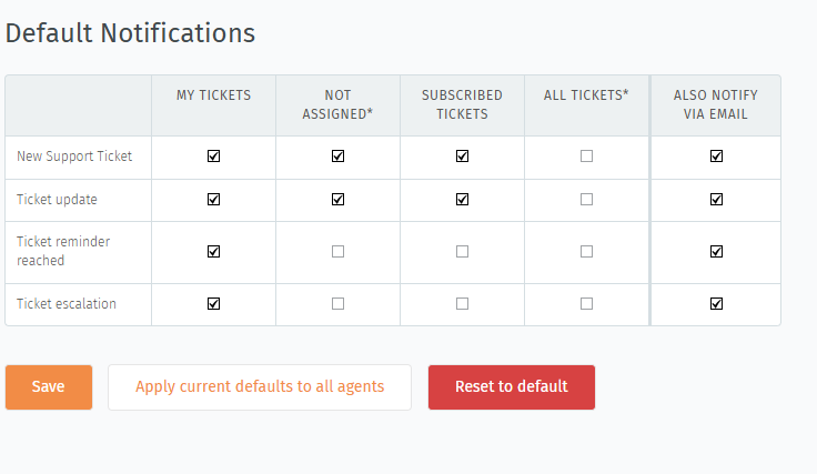

From the gui, I can see that users have notifications enabled.
