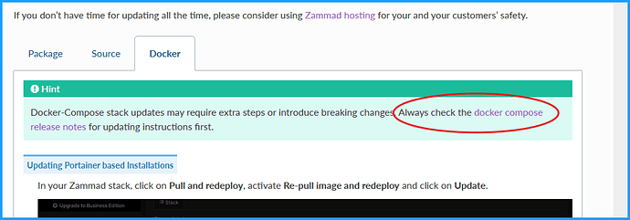

Last Week I updated Zammad to 6.5.1 documented here: Updating Zammad — Zammad System Documentation documentation at the Docker Tab.

Hi Bjoern,
nice to see, that you’ve solved it yourself. And thank you a ton for sharing that solution with others! For future reference and maybe others that stumble upon the same problem:
