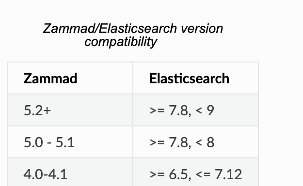

Well, we have a list of supported and required software versions. It’s not saying that ES9 is supported.
Why would you just blindly try and do it…? ^^

WDYM?
Higher or same as 7 DOT 8
and
Lower than 9
I don’t understand where you get that single v8 from?
v9 must be quite new, because our documentation links to current which, up to some days ago, was version8.

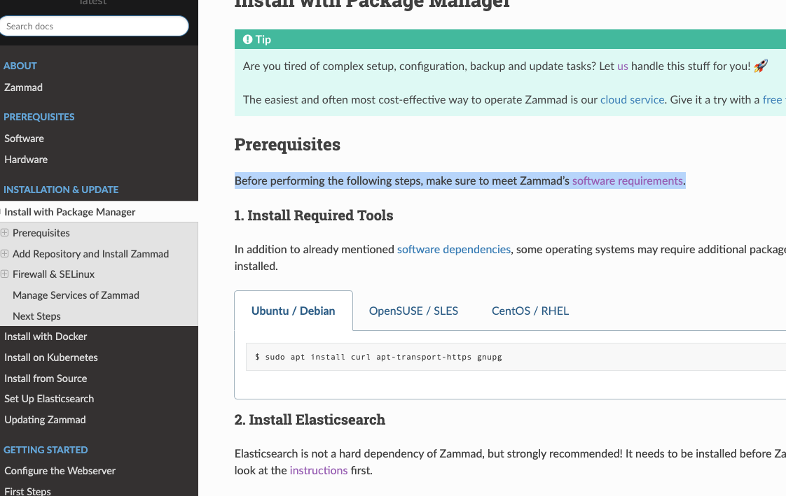

What I meant:
— here should be an image that I get an error over when trying to submit the post —
In a few spots in the “Set Up Elasticsearch” article of Zammad docs, you have those mentions of “for Elasticsearch >= 8 do this”. This isn’t incorrect in that those steps will still work with v9. Just that this suggests that maybe v9 is also supported when it’s clearly more recent than the Zammad docs. No big deal, just what confused me a little.
Honestly, I personally think that beginning a documentation from the start is extremely helpful. Because then you’d have to go over the software page.
The problem here wasn’t not reading the instructions, it’s the lack of obviousness which exact version the ES install instructions will install. For someone unfamiliar with either software package, that’s almost guaranteed to get missed.
I think that is the main culprit here, yep. The ES 9.0.2 package is from late May '25. It’s probably sufficient to just change the “ElasticSearch installation documentation” link in Step 1 of the “Set Up Elasticsearch” portion to this URL (which was probably what you intended to link to when v8 was the most recent ES release): https_//www.elastic.co/guide/en/elasticsearch/reference/8.18/install-elasticsearch.html
