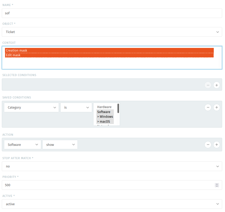

I set up a an object called category and set the type to tree and checked the shown option.
Then created multiple other objects one of which is called software and uncheck the shown option on those.
Then I set up a workflow to show the object Software (type select) when the user choose software but it still doesn’t show it on the ticket (I tried putting it in both the Selected conditions and saved conditions but neither of them worked)

You have another object setup called software, I assume with different values than the tree select, with no boxes checked for create or edit.
You have a core workflow setup with saved condition and the Software and subtypes selected, and the action being to show your software object.
This is telling the system to not show software until after you update the ticket. If you instead put it under selected conditions and then save your workflow it should be working. Also, if you already have a ticket open in a tab and update the workflow I’ve found I need to close the ticket tab then reopen it for it to show my workflow.

Thank you so much! I tried your suggestion and it did work when I created a new object with type “Select” but it still doesn’t work on object type “Tree Select”

If you still experience the issue, please note that you’ve slected “saved conditions”. Saved conditions have to be applied to the ticket before they can work.
