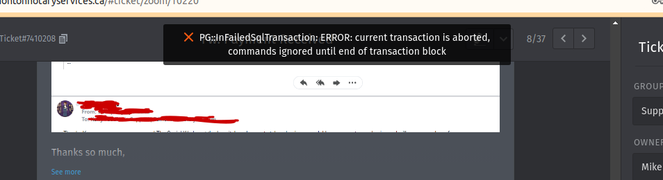

  • Error pops up:
  • PG::InFailedSqlTransaction: ERROR: current transaction is aborted, commands ignored until end of transaction block
  • Click on Ticket > Merge > select second ticket to merge into > Submit

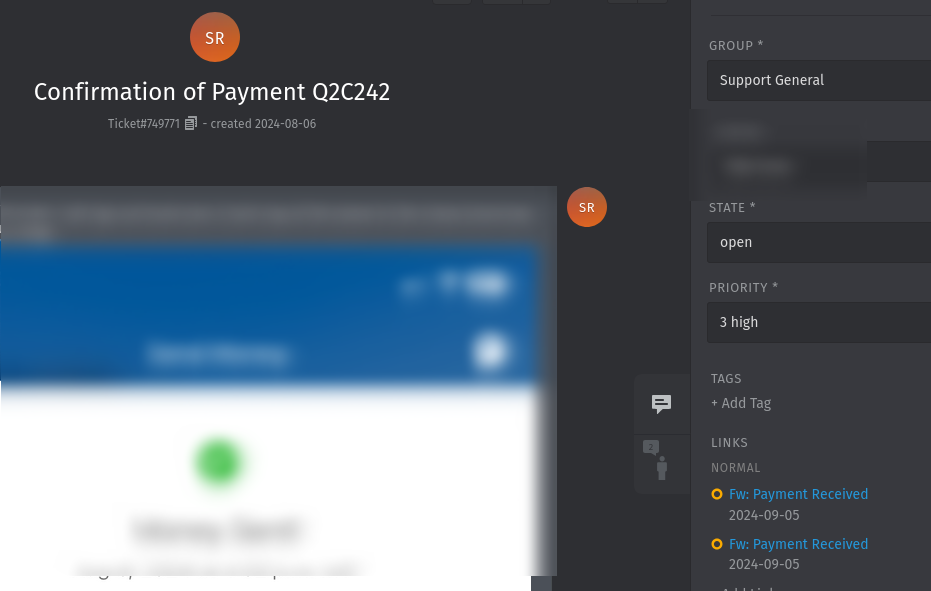

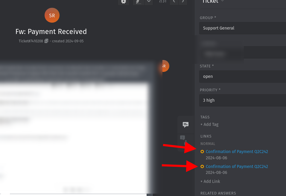

Well, something I noticed yesterday, is that the tickets this error appears on, does add a link to the other ticket I am attempting to merge on the right hand side of the ticket window.
Here’s an example:
So it merges, yet doesn’t close the previous ticket. Then I am guessing I try to merge it a second time, then the error appears? And a second link also is added, as if it did do it a second time anyways.

Ensure that all your migrations are up to date and executed. Easiest approach to re-run everything that happens during a Zammad-Update is to run /opt/zammad/contrib/packager.io/postinstall.sh.
There may only be one ticket link per ticket. The same ticket cannot appear several times. Most likely you skipped steps during the upgrade which causes a faulty database state.
