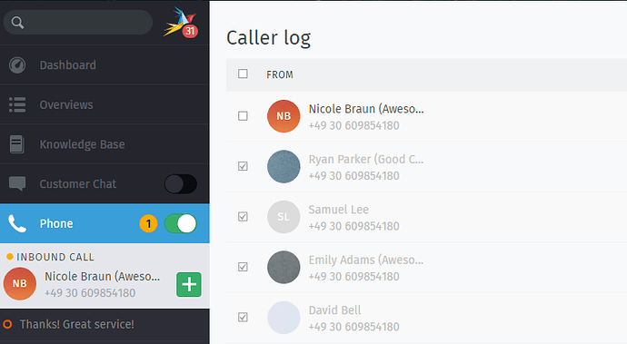

This will enable Zammad to know which sipgate extension belongs to which agent. As soon as an known agent picks up a call, a new tab “inbound call” will open. Also, for all agents (as long as the phone is ringing) Zammad will show additional call information.
This will look like so:

I don’t see a difference in the call info view (the little box that appears when a call comes in) and in the caller log.
Also, no screen appears where i can create a new ticket when i take the call.
And there is no additional call information shown.
