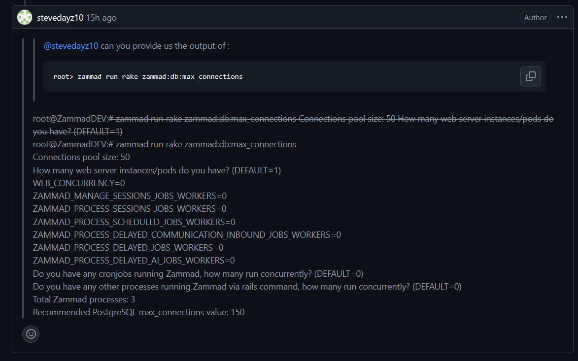

@stevedayz Some ideas what you could try out:
  • Update to latest stable
  • Increase your config/database.yml pool value - e.g. 100.
  • Rerun the zammad run rake zammad:db:max_connections to update the max connections for your postgresql config accordingly
  • Move the postgres server on the same server like the zammad server to exclude firewall, connection issues.
Such issues like you have here are mostly scaling or connection issues. Maybe the load is too big for your hardware or you have hidden connection eaters (scripts or modifications) or it’s a connection issue like firewalls or something.
