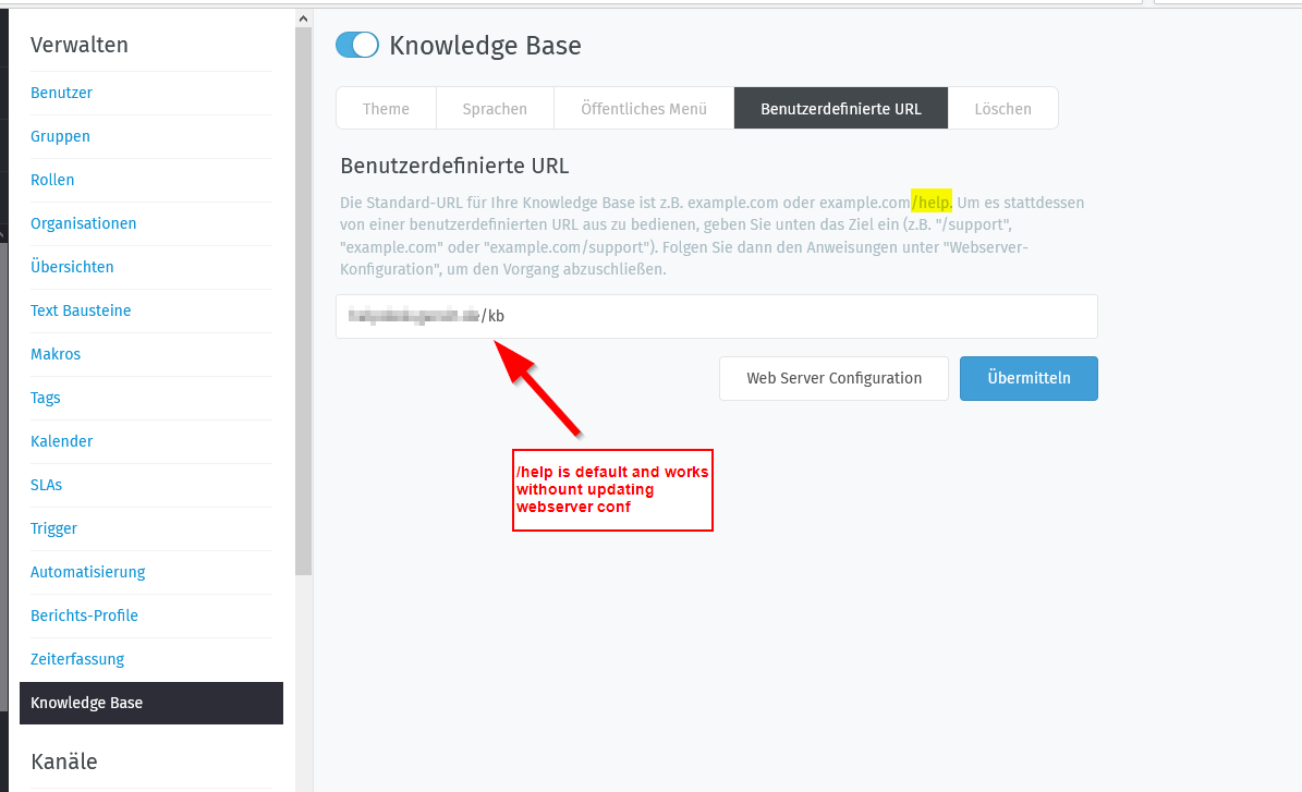

The default URL for the public knowledgebase page is /help.
Linked tickets are not visible to customers, unless they have knowledge_base.* permissions.
We believe (and consider) knowledgebase permissions as agent permissions not suitable for your customers.
I found my problem:
The URL settings are not default but the webserver config wasn’t updates.
The default URL is example.com/help but in our system someone chaned it to /kb.
