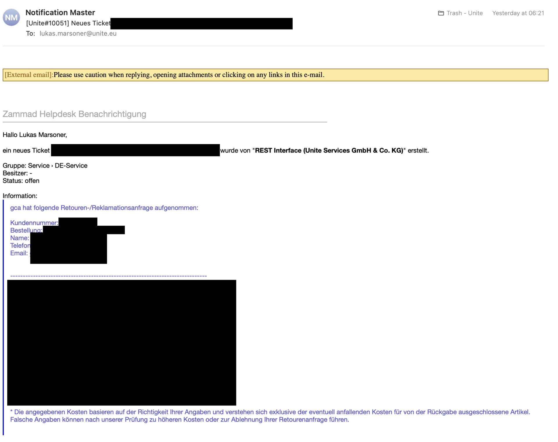

What kind of email is send out? Are these notification emails? If so, you can edit your profile to get only notifications for specific groups or actions.
Hi, no it’s the article itself that is send-out.
So in in my example this would be an email with:
Subject: Email subject
Body: Email body
What is the sender of this email? I mean that notifications contain the email body and the subject.

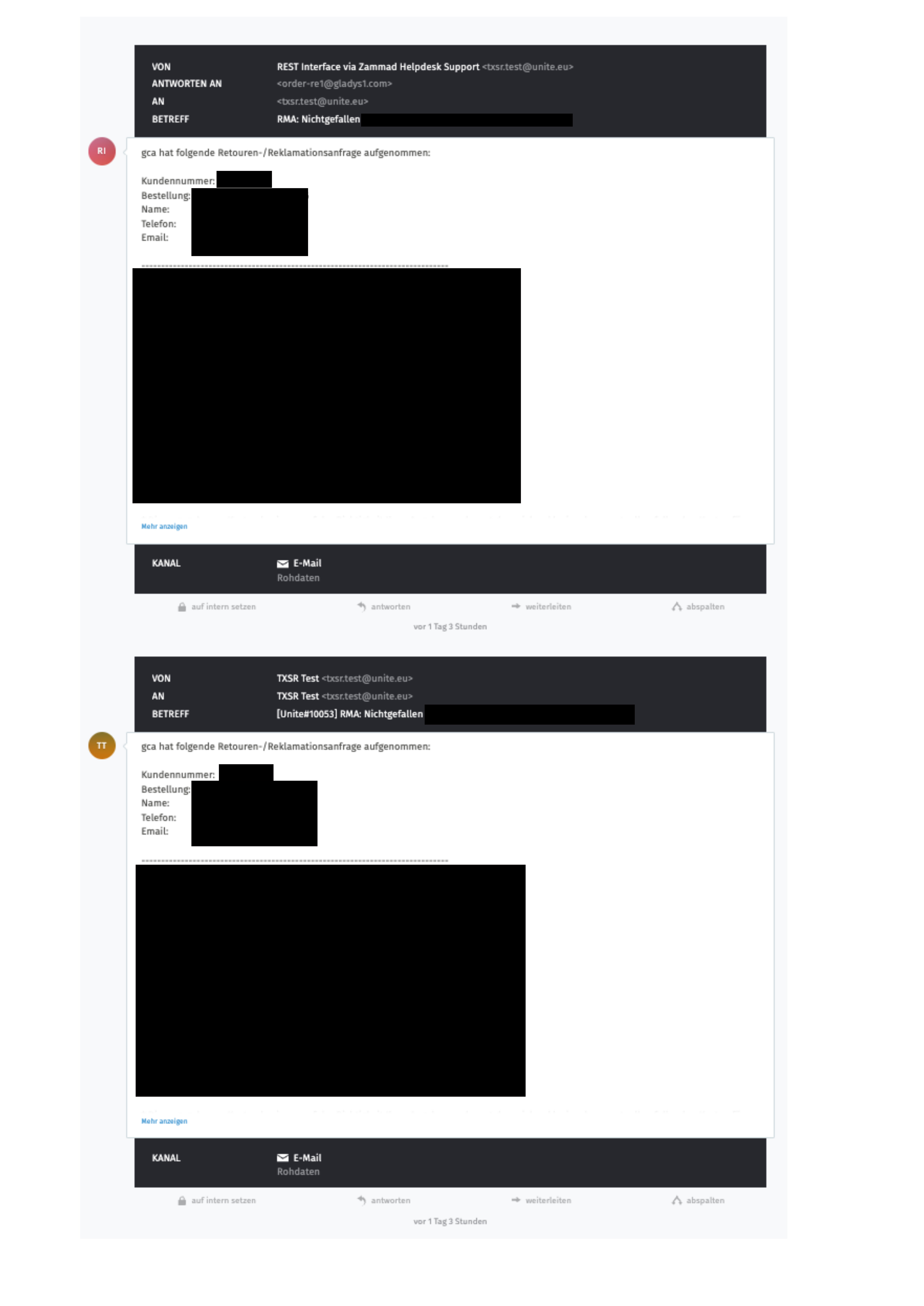

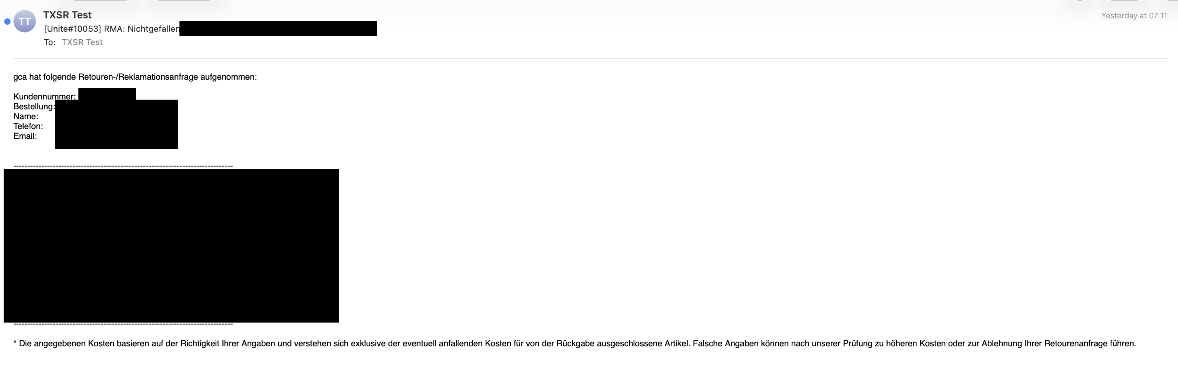

This I think illustrates it well. Here we tested setting the “to” address to an address from which emails are imported to Zammad and this resulted in the email created via API being added to the ticket again
Here a view of the raw-data of the email that was received
It seems to be the original email while updates look like this for us

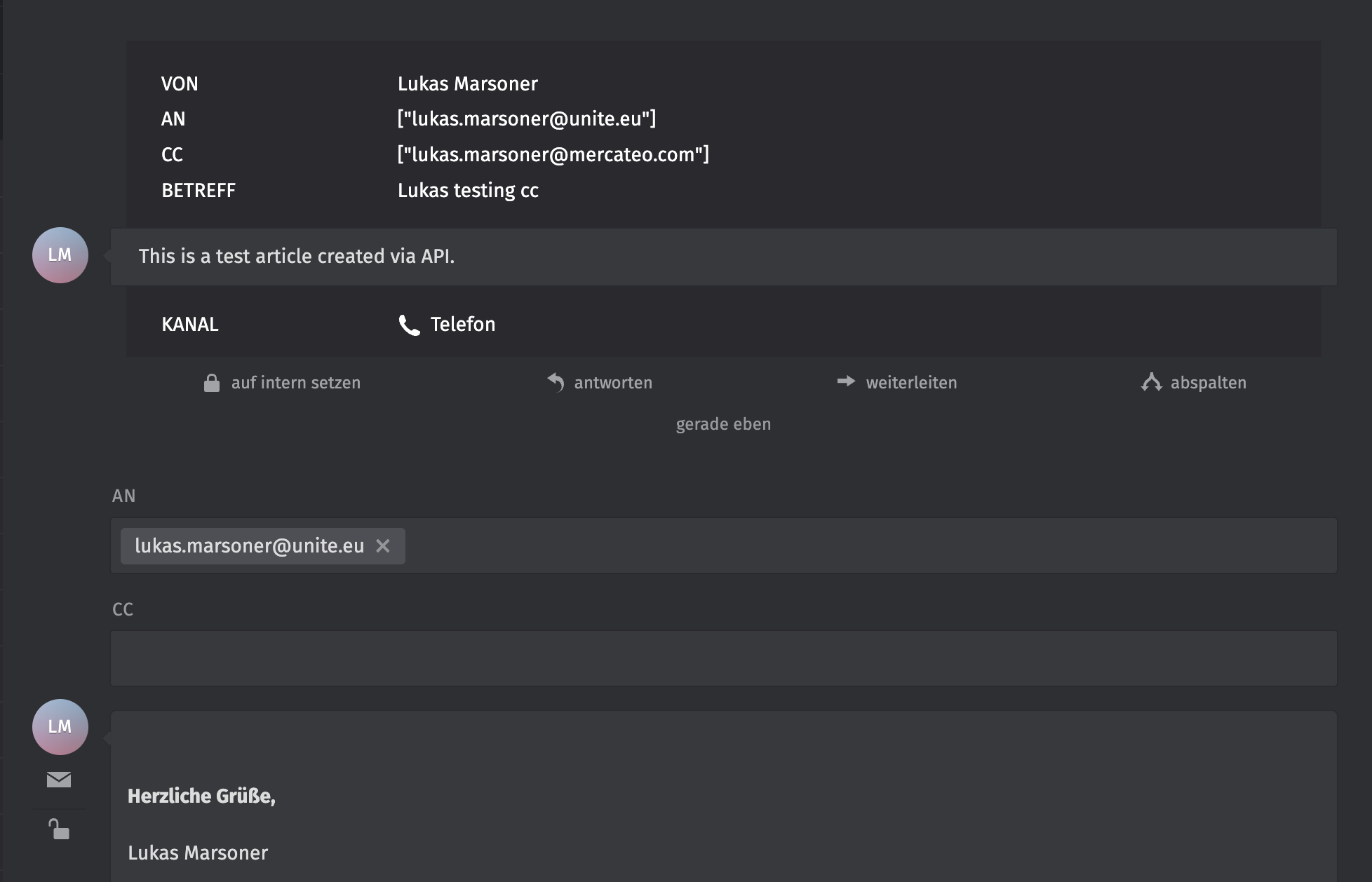

I did a bit of testing:
CC works but does not populate the cc in the “reply”
TO works fine
I think this is fine :slight_smile:

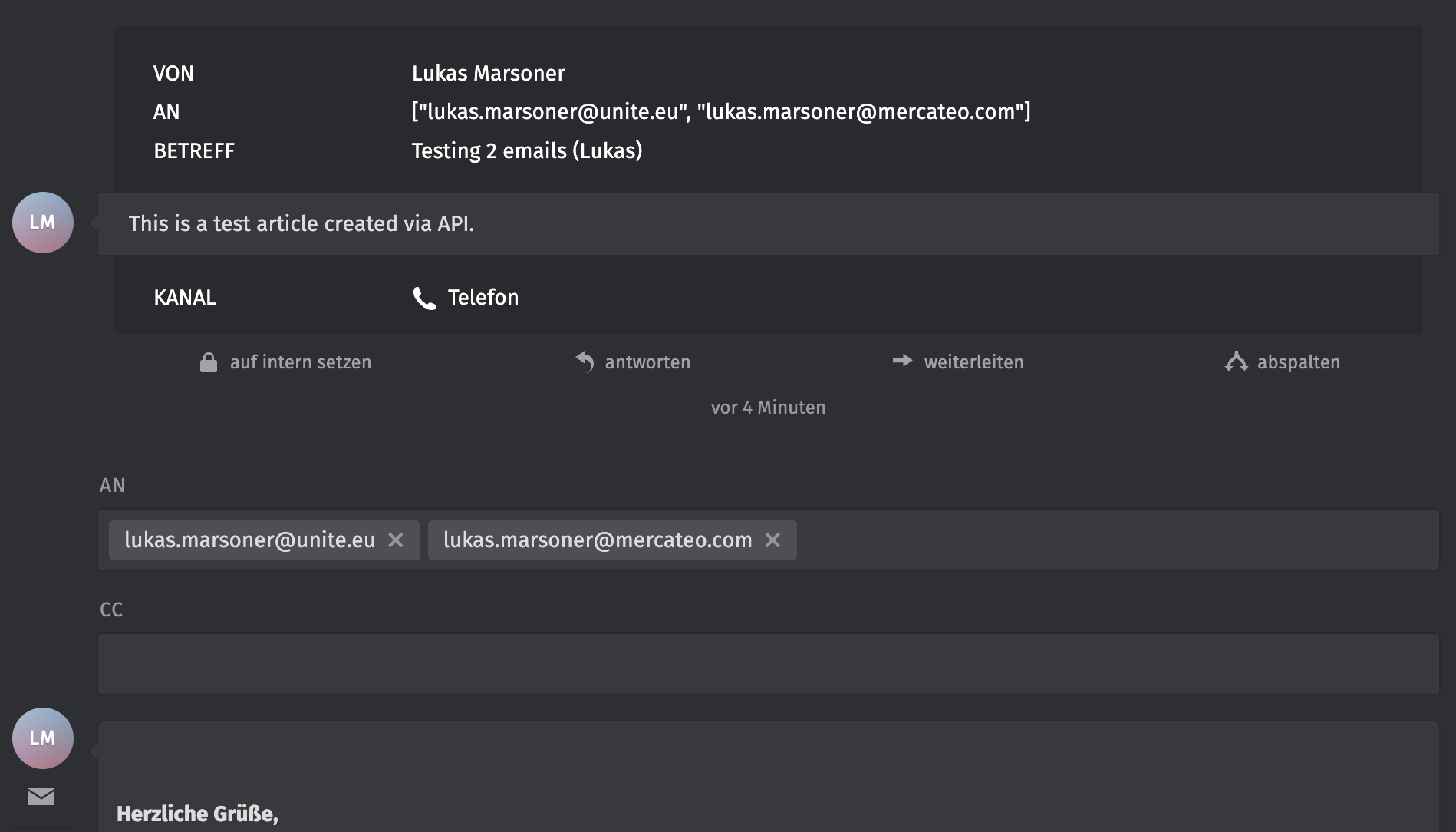

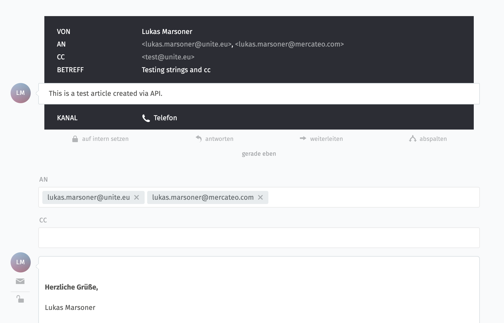

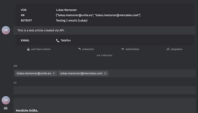

Hi.
Your To/Cc fields in the UI look strange, like an array. Are you sure that this is correct?
Hi :slight_smile:
I’ve created it as:
    article_payload = {
        "ticket_id": ticket_id,
        "subject": article_subject,
        "body": article_body,
        "to": ["lukas.marsoner@unite.eu"],
        "cc": ["lukas.marsoner@mercateo.com"],
        "type": "phone",   # or 'email' depending on use
        "internal": False
it looks a bit strange but works fine :slight_smile:
to and cc should be strings IMO. :slight_smile:
Works fine but other than visual-representation the result is the same :slight_smile:
