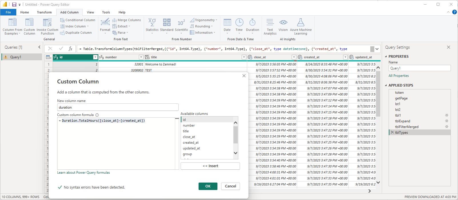

Once you have the query PowerQuery you should be able to add a calculated column to calculate the duration from the created_at and closed_at columns.
- Go to Add Column (ribbon) → Custom Column
- Set a ColumnName (e.g. duration)
- Enter formula:
Duration.TotalHours([close_at]-[created_at])
It should look something like this:
Here’s some more info on the Duration formulas if you need different units (days, minutes, etc.): https://learn.microsoft.com/en-us/powerquery-m/duration-totalhours
