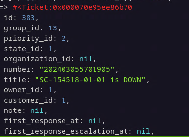

  • The group is set correctly, the organization is not
    organization_id is not set (nil)
Set up Organization(s)
Set up Group(s)
Set up CheckMK integration
Get group_id and organization_id using rails console commands
Test curl API call with defined group_id and organization_id
export NOTIFY_HOSTPROBLEMID=123
export NOTIFY_HOSTNAME=SC-154518-01-01
export NOTIFY_HOSTSTATE="DOWN"
export NOTIFY_HOSTOUTPUT="CRITICAL - Host unreachable @ rta nan, lost 100%"
curl -k -X POST \
  -F "host=$NOTIFY_HOSTNAME" \
  -F "group_id=13" \
  -F "organization_id=8" \
  https://zammad.example.com/api/v1/integration/check_mk/<token>

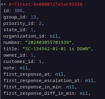

I also tried to set a customer_id=3 which is member of the organization_id=8 but that did not work either.
export NOTIFY_HOSTNAME=SC-154542-01-01
curl -k -X POST \
  -F "group_id=13" \
  -F "customer_id=3" \
