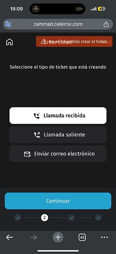

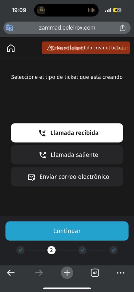

Cant create new ticket on mobile view
  • Used Zammad version: 6.5.0
  • Browser + version: Chrome. Safari
On mobile view, when creating a new ticket show me this error: “Error: the ticket could not be created.”. Tried on iOS Chrome, and Safari
