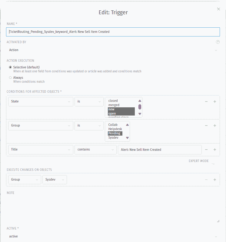

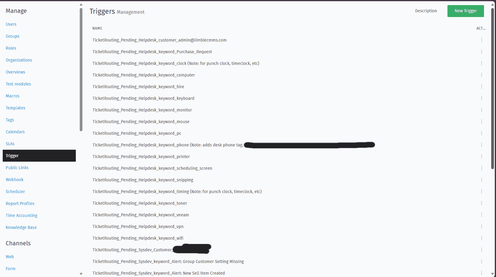

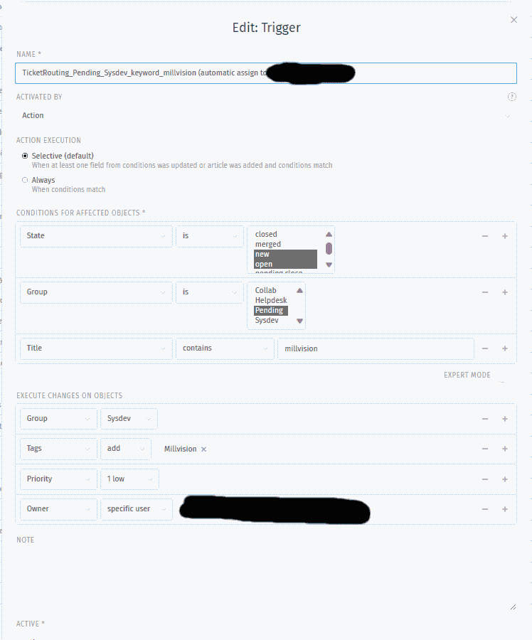

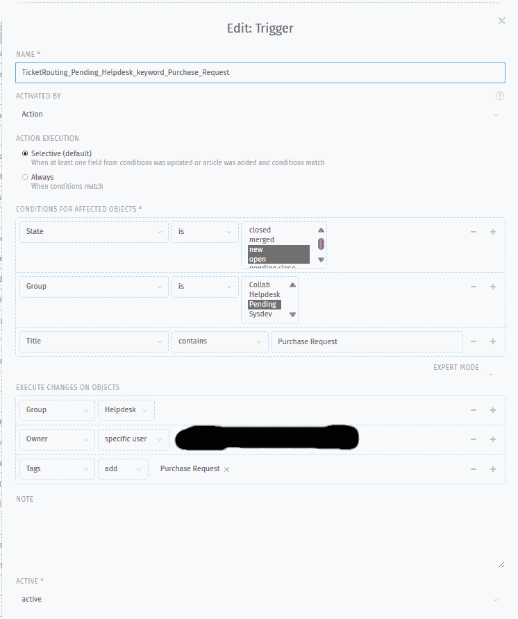

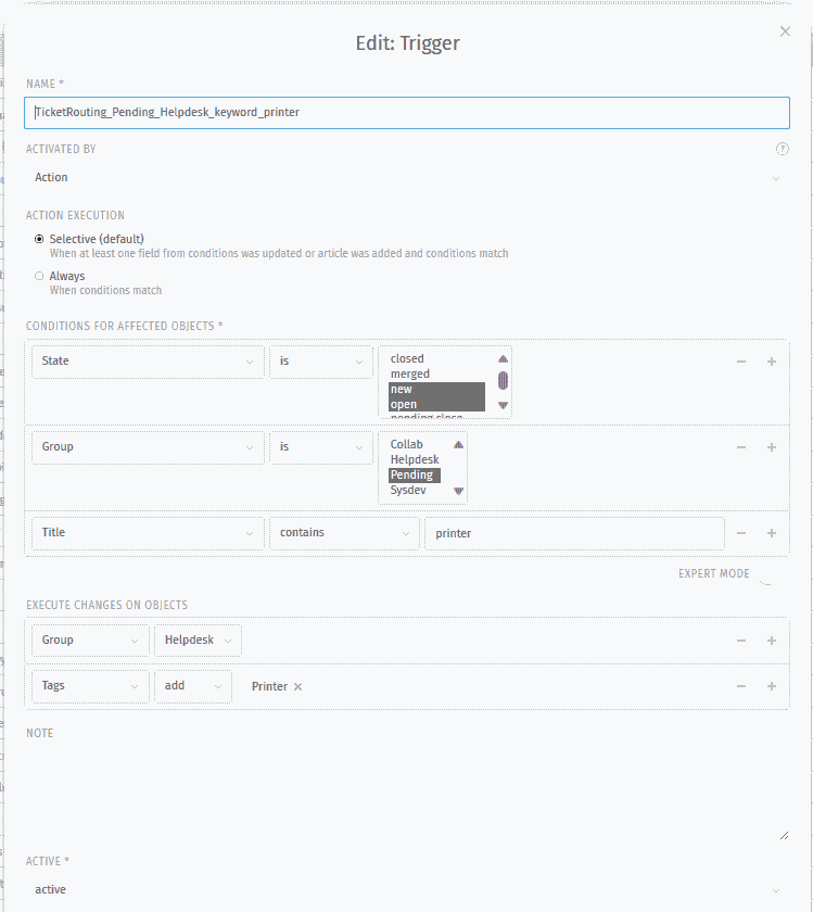

Customers send emails to helpdesk@example.com, and we use Zammad triggers to check for keywords in the body text of incoming emails, and use it to assign tickets to specific technicians or groups, add ticket tags, or set priority.
I’ve attached a few screenshots below, showing how we have these triggers set up. Let me know if you have any questions.
