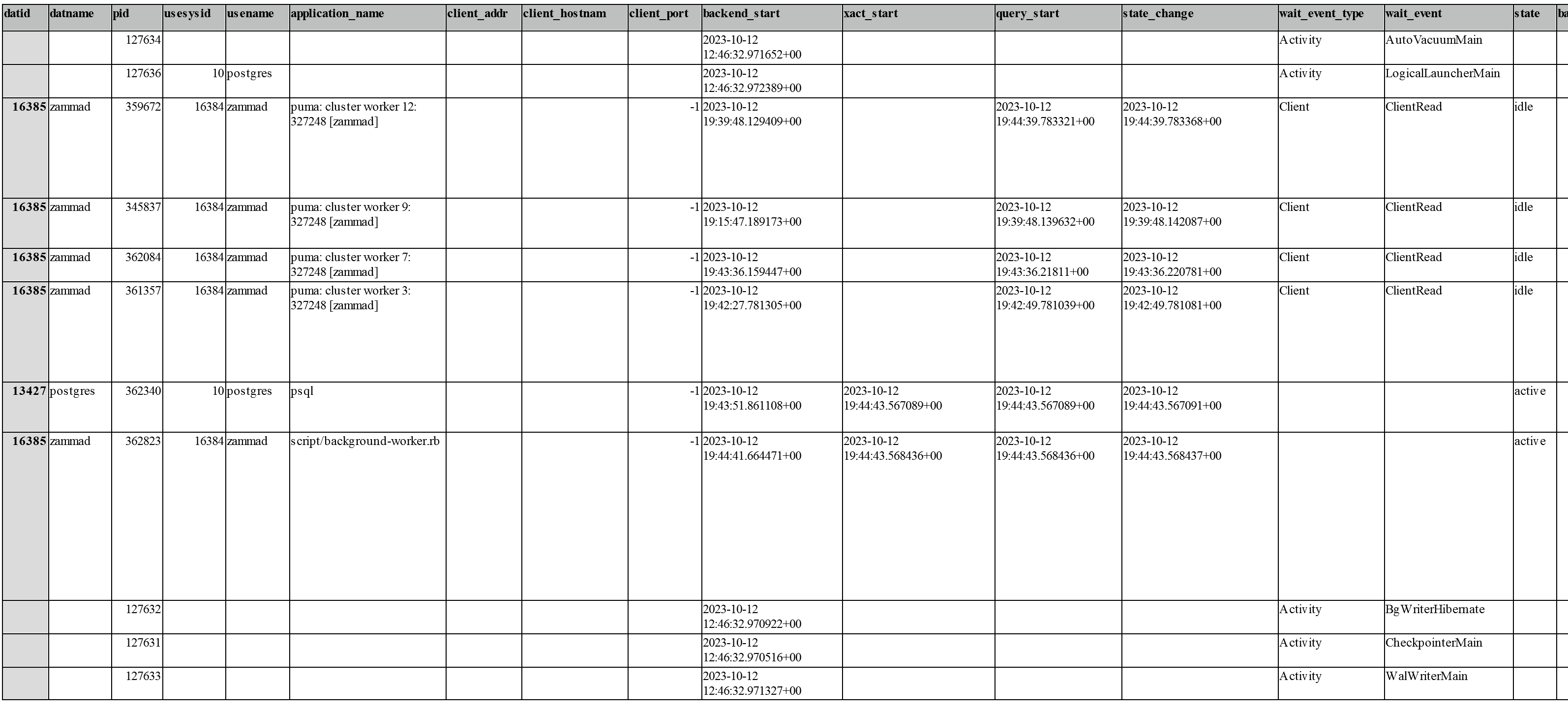

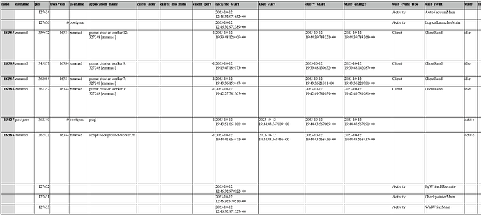

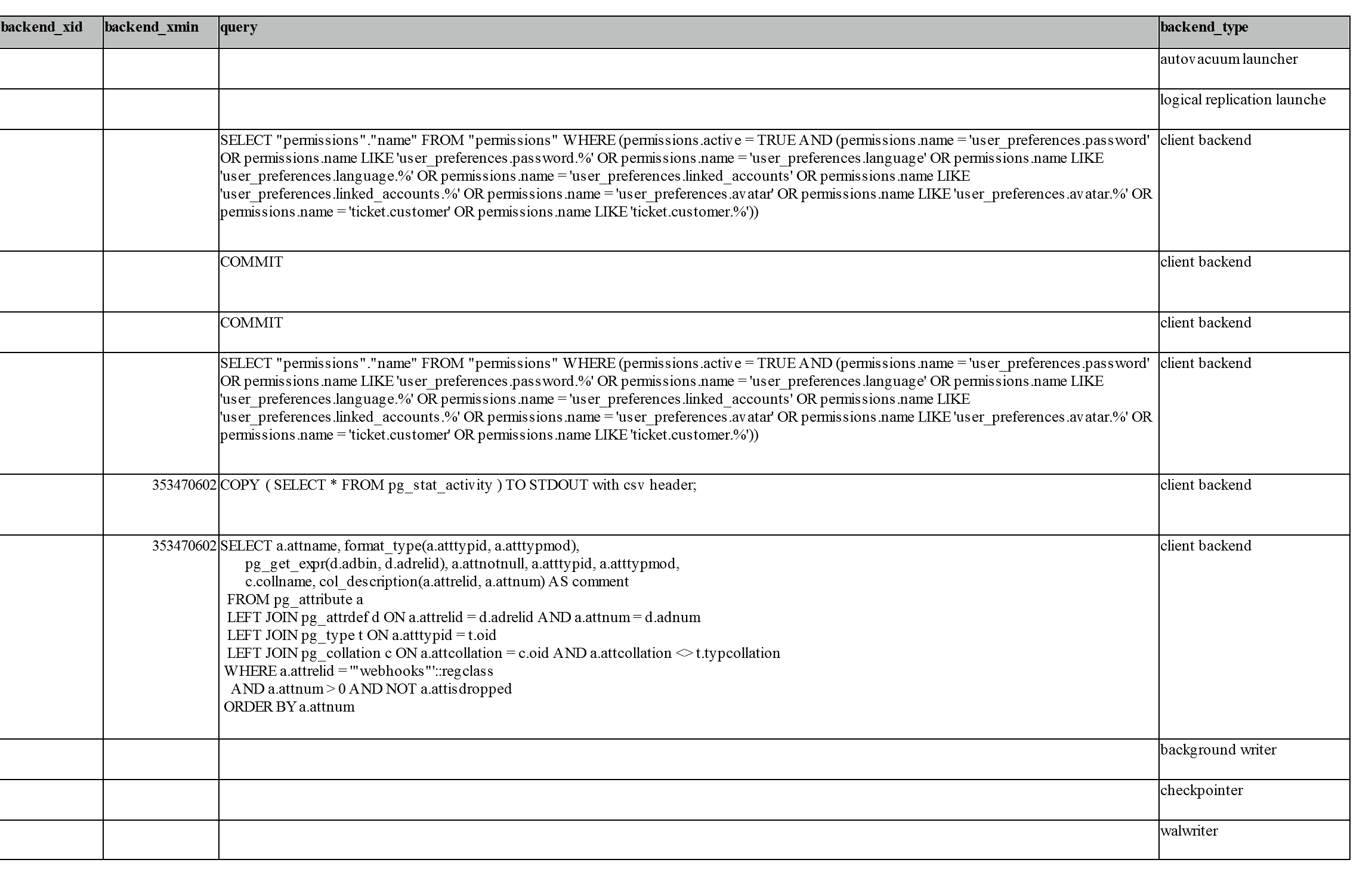

I also run the queries for postgresql, but it seems that a very low number of queries are running

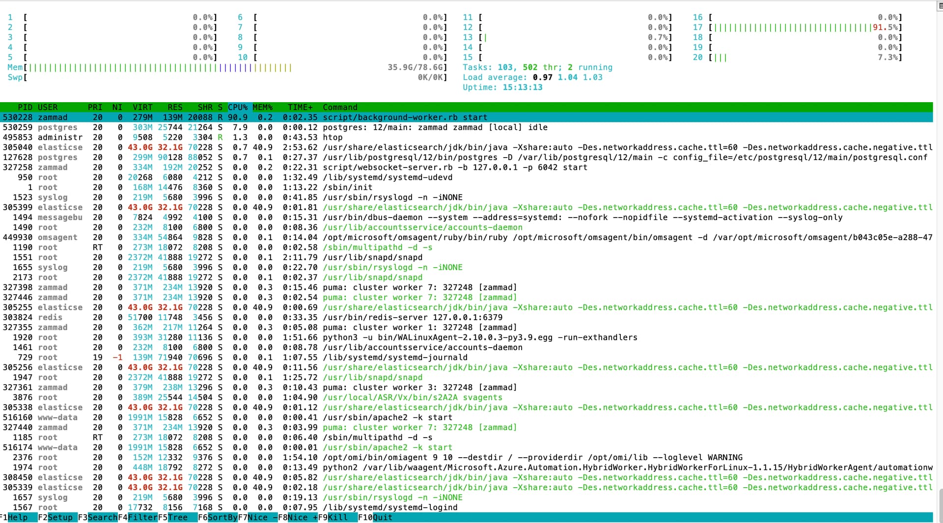

Here is also the htop screen :
Okay, so a couple of things: you have 20 CPU cores, of which 19 are basically idle and only one is currently utilized. This matches up with the system information in one of your previous screenshots, showing a system load of 1.01. The entire machine, I’m guessing a VM on the Microsoft Azure Cloud, is basically doing nothing, apart from the one background worker process. This could mean either the background worker tuning isn’t working (I would have expected more active workers processes), or the background workers are hindered by a locked job preventing them from processing any delayed jobs. The latter appears to be the case looking at the production.log output.

The currently running queries in the database don’t really show a problem, but that is only a snapshot at a certain point in time.
