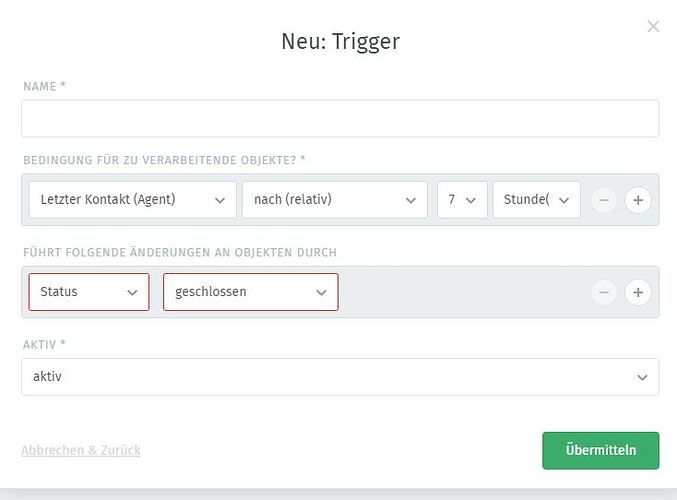

i think the trigger already exist in R2.3 with a relativ time
trigger → last contact (agent) → relativ time → 7 days
I have created two test tickets:
27014 last reply agent: The last answer comes from an agent
27015 last reply customer: The last answer comes from a customer
The automation rule does not show any hits.
Automation → last contact (agent) → relativ time → 1 minute
When I add the condition “Status → open” both tickets will be shown.
I think I need a condition like “last ticket message comes from a customer → True” or “last ticket message comes from an Agent → False”
PS: Using zammad V2.3
