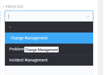

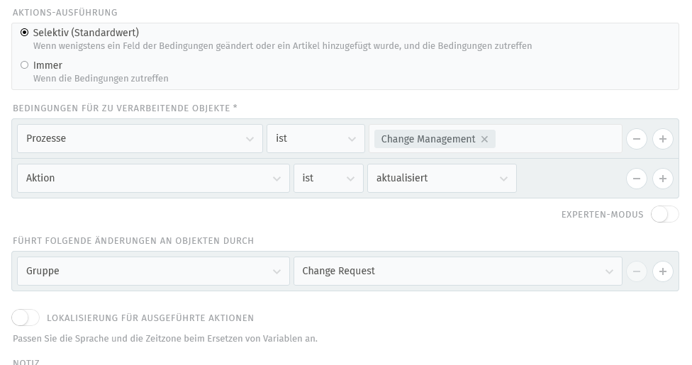

You can also add a new dropdown / tree field for diffrent processes and add a trigger to change the group. For example you have your normal Entry Point Group like “Inbox” → the place where every new tickets are created. Now they can choose from the Dropdown “Services” the “Repair-Process”. If they do so a trigger switches the ticket automatically in the right group.
The Trigger
When a specific dropdown entry is selected, switch the group.
