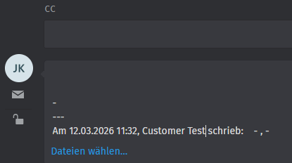

  • it just adds a dash - to the text

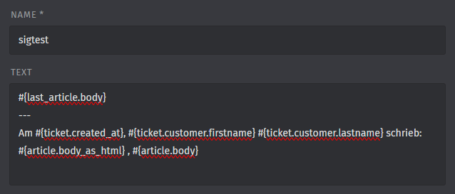

  • set up a signature with eg #{article.body} and reply to an email in the group the signature is assignes to
  • add a text module with the same variable → same behavior
  • also tried with an actual customer mail if being agent and customer at the same time is a problem → same behavior
  • tried multiple variations of first_, last_, created_, .body_as_html and so on variations as mentioned on the admin docu

Of course this won‘t work. The signature loads variables when you begin to write the article. The article body is not available at that point (for obvious reasons).
This is a limitation the documentation also hibts you about.

You could enable full quoting in the composer settings instead lf manual fiddling. There‘s no option to deliver a whole history with a variable.
Thanks, that was exactly what I was looking for. Tbh I checked all settings several times but not this one in the ticket itself.
