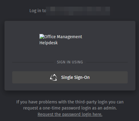

After update to Zammad 6.0.0 brand logo is broken (only docker version)
  • Used Zammad version: 6.0.0.
  • Docker version: 20.10.21
  • Docker-compose version: 2.17.3
  • Operating system: Ubuntu 20.04
  • Browser + version: Brave (Chrome)
Expected behavior
  • The logo should be shown as usual
Actual behavior
  • The Image will no be shown
Steps to reproduce the behavior
  • Update to version 6.0.0
  • Upload a new image
More information
  • If I try to reach the image URL I get a “404 Not Found” issue. I already tried to replace the image but no luck so far. After I changed the Image the URL changed but still 404. I don’t see any errors in the log during the upload of the image nor during the apply of the new image.
  • The URL path are: /assets/images/81ca9e375fc64fca5b8e0cb4865a076e.png I saw in the logs that the folder path where the image is searched is “/opt/zammad/public/assets/images/” inside the zammad-nginx container. But if I take a look it seems that there are only generic images from Zammad itself in it
  • I updated two Zammad docker instances and on both instances the image break. The second instance is currently not in use and nearly new.
  • Update from Version: 5.4.1 to 6.0.0
  • I also updated a instance which is managed via Debian package manager on a Debian 10 system and after the update we had no problems with the brand logo. So it seems that only the docker instance are affected.

@kevinrode thanks for the report. I believe this is a bug caused by recent changes in docker handling and created an issue here: Enable Notifications​ After update to Zammad 6.0.0 brand logo is broken (only docker version) · Issue #354 · zammad/zammad-docker-compose · GitHub
Yeah I thought so to but I thought I open up a thread here first to be sure that I am not the only one before I open up a bug report in Git.
But anyway: Thanks for opening the Bug report. I think we can close this thread here and we will see the further updates inside of the bug report :+1:
