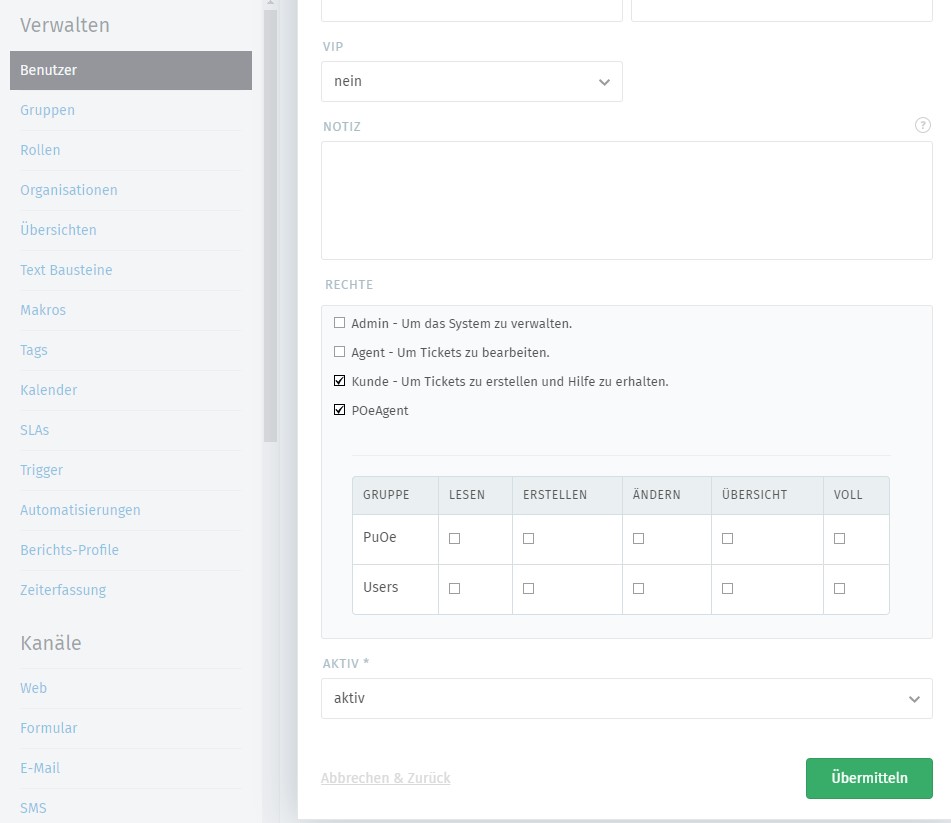

I now assigned the AD-group to my role and re-synced with the AD. The users in zammad appear successfully in the designated role. However it did not copy the access permission to the group that was set for that role:
You can’t see the access rights on the user site.
As long as the user has the tick on said role it’s perfectly fine.
ok, I just verified that with a test-user
