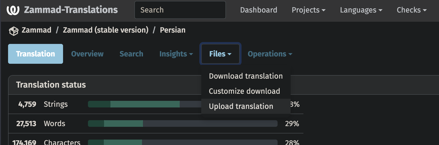

For that you simply go to the project, change into the component (this step is important) and select your language.

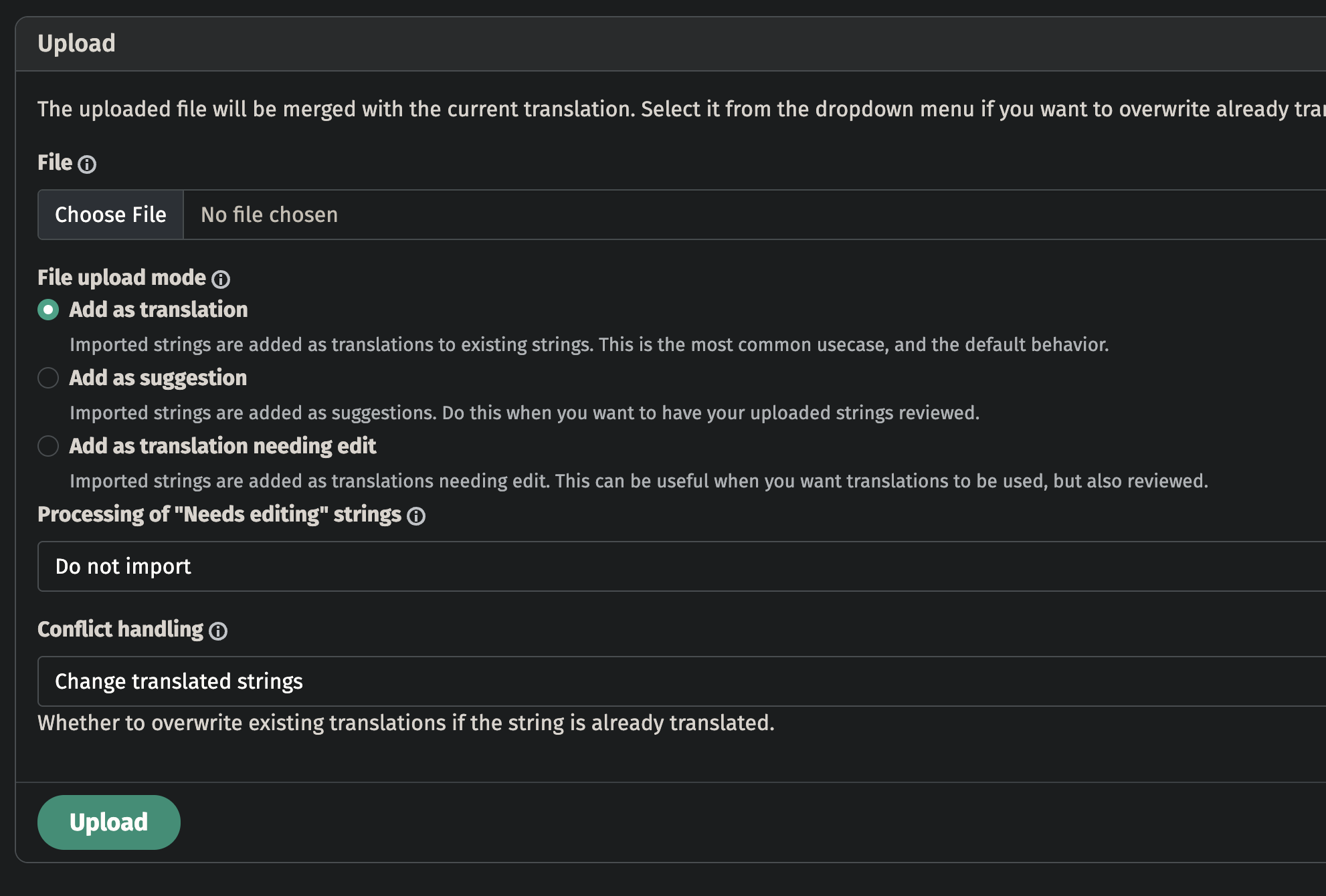

You then navigate to files → Upload translation.
From there you can add your translation file. Make sure it’s fitting the environment (stable / develop).

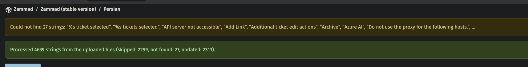

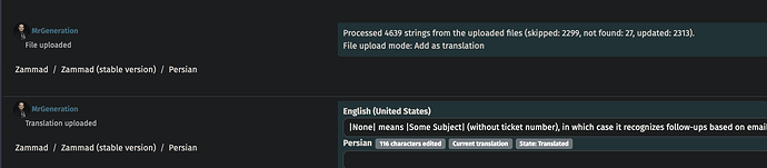

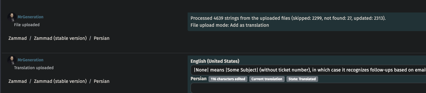

I added the stable translations for you just now. Had to wait roughly 5 minutes - but I’m honestly unsure if I added the translations as “you” (the way I intended to).
That bumped the translation state from roughly 12% to 96% which is a great bump. :slight_smile:
Looks like I stole your credit… sorry for that. :frowning:
