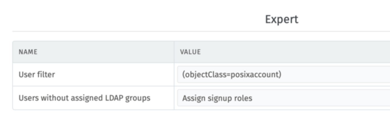

You could set “Users without assigned LDAP groups” to “assign signup roles”.
See the documentation.
That’s what I meant (sorry, running with the German translation) - setting it to that did not do anything …
You have to re-activate the inactive accounts manually. After that they should stay active.
Nope, doesn’t work … reproducable … Set the account to active, run the manual sync, user inactive again … tried with additional accounts, too, not just the one I kept using … same behavior. As mentioned before, not all accounts marked as customer are deactivated, though … not sure what the difference is, they look the same from the Web GUI …
