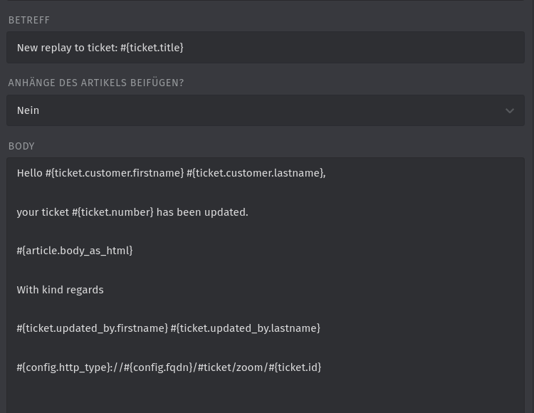

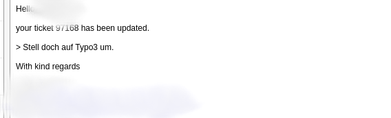

Thanks for the fast response,
I changed the trigger to #{article.body_as_html} and the quotation marks are still there.
I also updated Zammad to the last version and it’s the same.
My actual trigger rule:

The mail:
