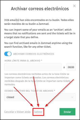

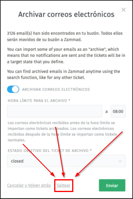

After re-authenticating the shared mailbox connection in Zammad, all emails from those shared mailboxes were imported again into the system. This happened multiple times this morning after different re-authentications.
We did not change any configuration here. The only action performed was re-authenticating the accounts after MFA was enabled.
We also skipped the ‘archive emails’ option because we wanted to avoid importing all emails again, but the issue still occurred.

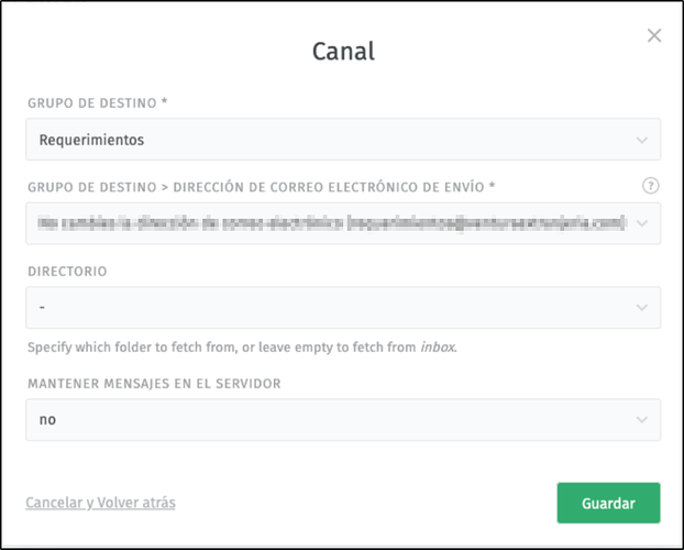

Normally, this should not be the case, because the emails are already marked as read.

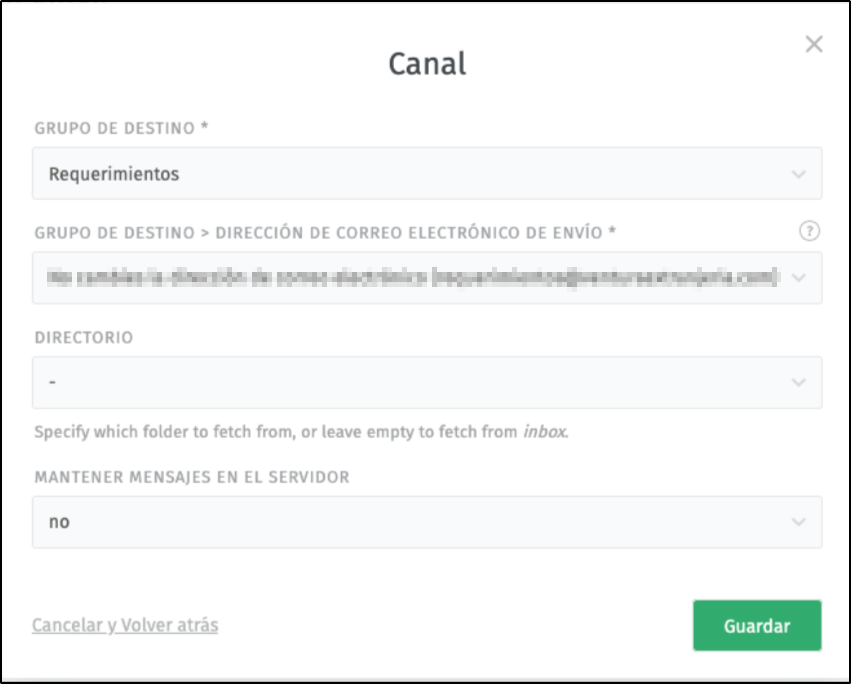

Look at the screenshot. Keep messages on server: no. Possibly the form ‚forgot‘ the setting state and begun importing the read mail. Technically a data loss if the admin doesn‘t notice.
In my tests, the form is working as expected and uses the “previous” value. So when “Yes” was selected before, it’s also pre-filled like that in the form after a re-authentication.
That’s odd. The only other reason would be that Zammad would use a wrong authenticated user, but if I recall correctly that was fixed in 6.4 or 6.5 so this shouldn’t be the case for 6.5.2 as well…

After further investigation, we have identified that in some cases, the keep_on_server flag appears to be modified automatically during re-authentication. We were unable to find a consistent pattern, but out of 19 re-authenticated accounts, 8 had their keep_on_server value silently changed from true to false.
This caused emails to start being deleted from those accounts. Each deleted email was re-ingested into Zammad, regardless of whether it already existed in Zammad or whether it had been read on the server, generating duplicate messages.
We have JSON snapshots of the email account configurations from before and after the re-authentication. It is unclear whether the form failed to load the correct value or whether it was saved incorrectly. We did not catch it at the time because we had no reason to expect that setting to change on its own.
