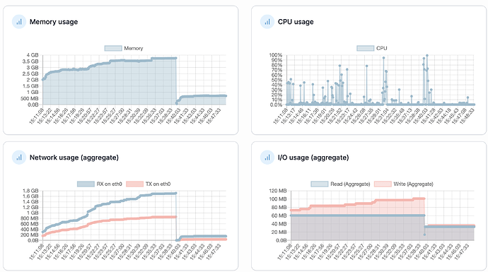

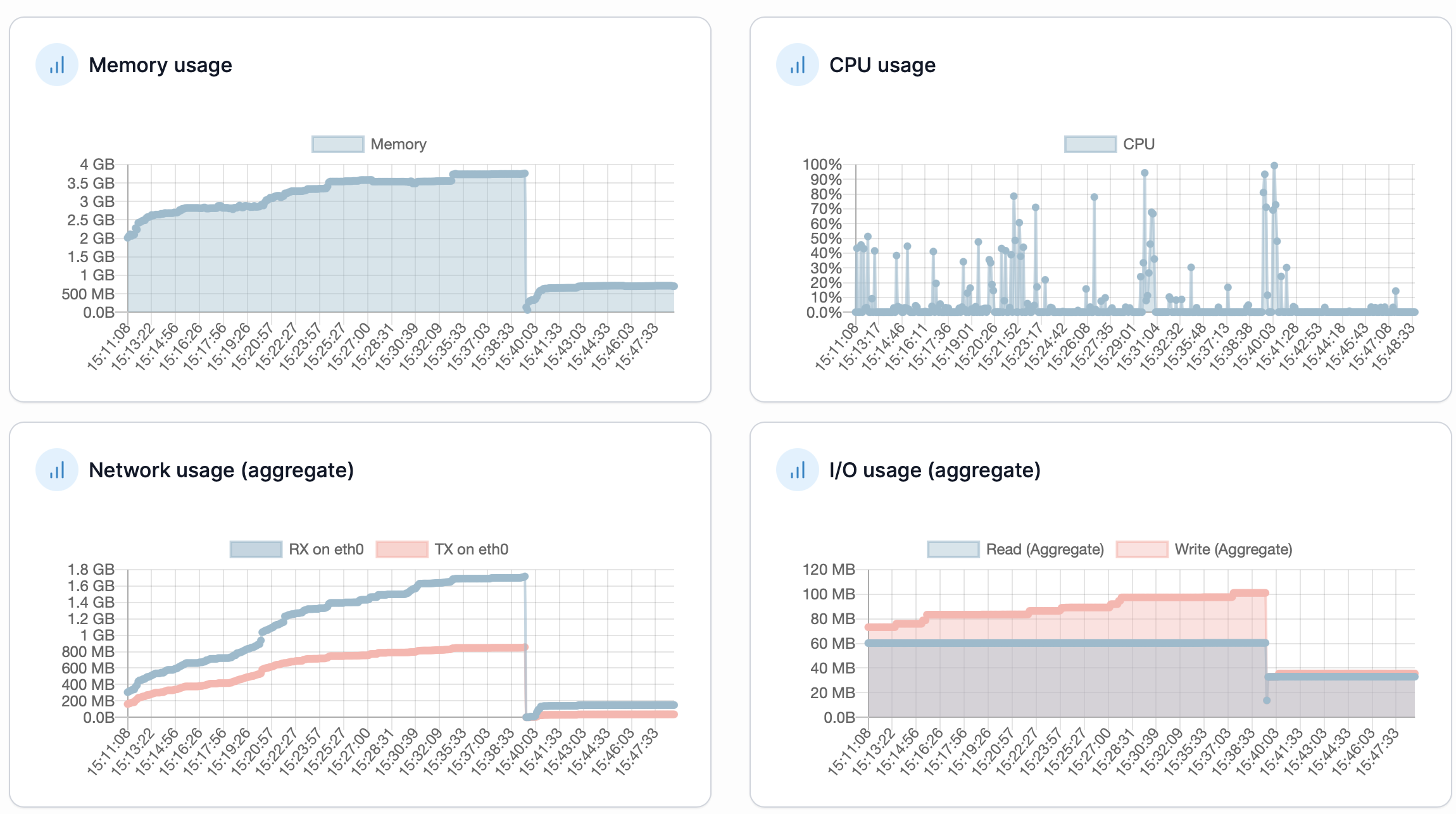

currently just 1 or 2 agents. The thing is that it seems to have started after I upgraded from 7.1.1 to 7.1.2 or 7.1.3 probably the last step…
everything I do on the system increases the RAM footprint but RAM never gets freed.
the dip is restart of the container once it reached 3.5 GiB
