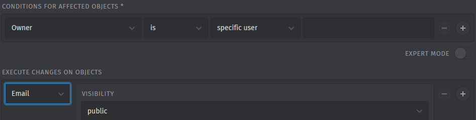

Workaround might be to include your external contact as a user in zammad and use a trigger like this:
Then you can just check the “send attachments” box
The mask of the Trigger is quite the same of the Macro, the option to include the Attachment is there:
grafik
I tried with the Trigger and i got the same result: Mail sent, but not the Attachment
I suppose it only send the Attachment from the last Article, but somehow the other Actions make something like an Article and so no Attachment is sent. A solution could be to take the Attachment from the first Article, if there is a way to do that.
