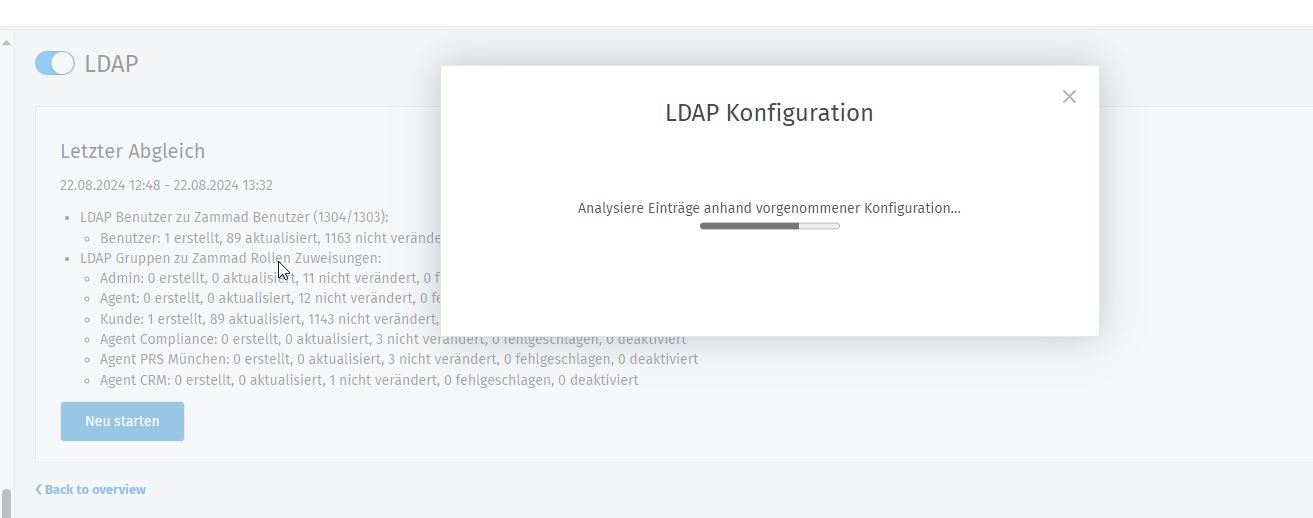

I added updated an existing LDAP Source to use SSL. Analysis of structure started and at about 70% it stucks. After waiting one hour I closed and tried again. Now the analysis Popup always show 70% and the LDAP sync isn’t working any more.
One person had this problem, too: Ldap Stuck on Analyzing - Technical assistance - Zammad - Community
I tried to update Zammad by package, restart zammad, restart Server, clear cache, rebuild search index. Nothing helps.
Is the progress of the analysis task somewhere stored in database?

that will solve my problem with the sync task. But my problem with adding a new source is still there. I am not able to add a new AD Source, because it stucks at analysis.
yes that’s right, I also have the same problem. As I said with upper commands you can only sync once but whenever you go under integration/ldap, the “restart” button doesn’t work and when you click on source this bar hangs.
