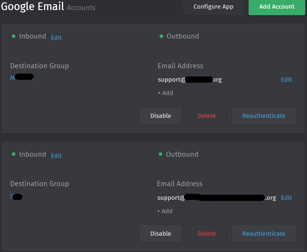

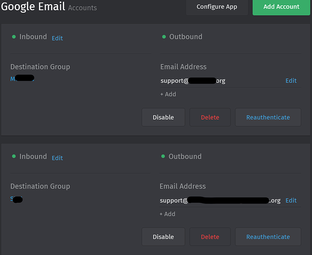

  • Adding a new Gmail account should not replace a separate existing accounts client secret.
  • Adding a new Gmail account breaks an existing account’s client secret. We are trying to add a 3rd separate Gmail account, each with its own client IDs and secrets, but adding the 3rd account breaks one of the existing accounts, as it’s not retaining its own client secret and trying to use the new account’s secret.
  • Reauthenticating does not fix the issue because Configure App needs to be set, creating the issue loop.
  • Add new Gmail account → Configure App → Add account.
  • Separate existing account throws error:
    Can’t use Channel::Driver::Imap: #<RuntimeError: Failed to refresh XOAUTH2 access_token of provider ‘google’: Request failed! ERROR: invalid_client (Unauthorized)>
  • Production log shows that the existing Gmail account is trying to use the new account’s client secret.

I get what you’re saying and what’s officially supported, but that’s not how our Google channel has successfully been working. The 2 accounts shown are using different client IDs and secrets. They have worked perfectly for months. They were migrated when the Google Email channel came along due to basic auth going away. Is it possible that’s how they are working outside of what’s supported?
The invalid client comes after adding a 3rd app/account. Once added, the new app works correctly, but breaks the top account shown; no impact to the middle account..Production log shows that Zammad tries to use the 3rd apps client secret for the top app, but retains its client ID. Interesting behavior!

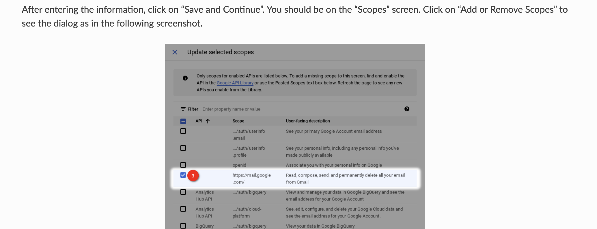

Also, it seems that the documentation is still missing a step, as discussed in this post: Zammad Community Post.

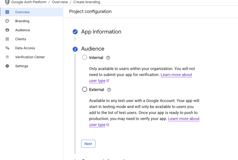

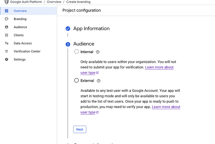

Yes and no. That highly depends on the user type you choose.
Your statement is only correct if the app type is internal. As we’re talking about about Zammads mail channel in a very defined and (closed) way that only admins have access to, external should be very well good enough.
At least I don’t see any bad vectors that might get your rear here.
Not really no. While this part was adjusted, technically it was there before too.

Thanks for pointing out the external option. I initially thought it was for testing and had some security concerns, but I will take another look. It appears that this may be the route we’ll need to take since the alias option isn’t using the From address as we had hoped. It seems to still be limited by the group sending email address, rather than the Gmail settings for “Send mail as” and “When replying to a message - Reply from the same address the message was sent to”.
If anyone encounters a similar Google issue, we had to go with the external audience option. This required an additional step for enabling the Gmail API, as mentioned in this thread. The production log pointed us to the exact link where we needed to enable it, which was really helpful! It appears to be different from what is described in the documentation concerning scopes. A possible feature request would be the ability to have a client secret per Google account.
