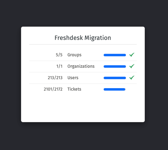

API rate limiting during a migration doesn’t give the end user any visual indication that they are being rate limited. The numbers just pause.
2) Which are one or two concrete situations where this problem hurts the most?
I just completed a FreshDesk migration and was rate limited a few times during the migration. In the browser, the numbers just paused for ~45 minutes after I got my 429 response. In the logs, I could see the 429 response, the retry-after value and status is: sleep but that isn’t displayed in the browser UI anywhere for the end user.
What the end user sees is just their numbers stop for an extended period of time. They may think their migration has broken or something has gone wrong. Here is what I saw the last time I was rate limited:
